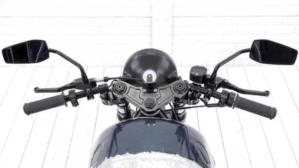

The handlebar controls are not the most difficult, but probably the most enjoyable work within the project. We have already assembled the fork, yokes, adjustable clip-ons and Motogadget digital switches, so it was time to assemble all the controls and connect the cables. Footpegs are also adjustable, which allows you to accurately adjust the riding position and handlebar.
When assembling the handlebar control, we tried to keep the factory clutch and throttle cables so that they could be easily replaced if necessary. Everything else was done from scratch. We removed the choke cable because the engine is exposed, so the choke can easily be opened by hand on the engine.
The original throttle cable has a plastic tip on the outer sheath, which can be easily adapted to any throttle assembly. We chose the minimalistic Biltwell handle, which is suitable for 120 mm long grips.
Clutch cable on BMW K1100LT has a non-standard tip. To install this cable on the ABM clutch, we had to make an adapter and bushing. As a result, it turned out elegant and functional, plus we managed to save the factory cable. We decided not to do the clutch sensor, because there is a neutral indicator, so starting in gear is unlikely.
We chose soft LSL Clubman grips with good traction that are 120 mm long. Grips are made to fit a 22 mm tube, but their outer diameter is the same as on 1-inch grips. On our motorcycle such grips look massive and it feels nice to hold them.
ABM Short Caps bar ends fit best — they are compact and neatly cap the tube ends.
The choice of mirrors turned out to be the most difficult, especially since not everyone in our team uses them, so the appearance was just as important as the functionality. We settled on mirrors with stems - such mirrors seemed the most appropriate. ABM makes special lever clamps with mirror mounts, so mounting them was not a problem.
In general, the handlebar control turned out well, it looks good and is practical thanks to adjustable clip-ons! You can purchase all the spare parts and get some advice in our store!
