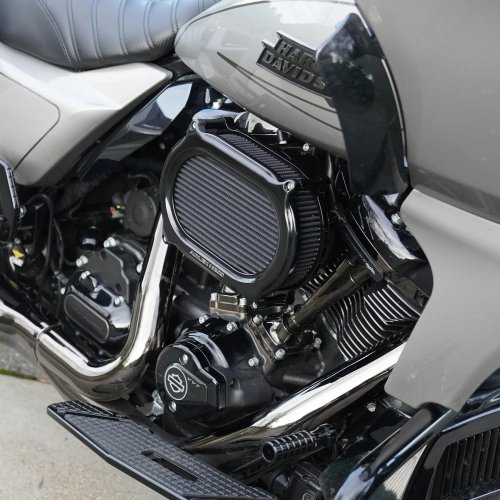

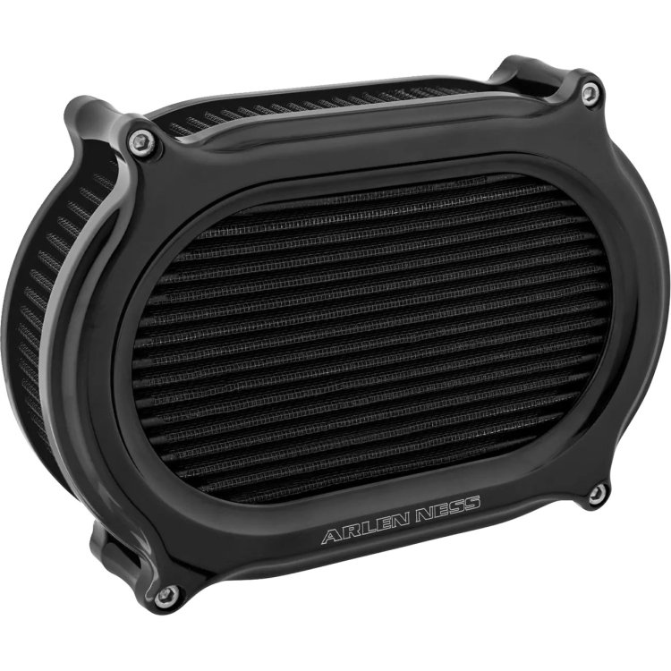

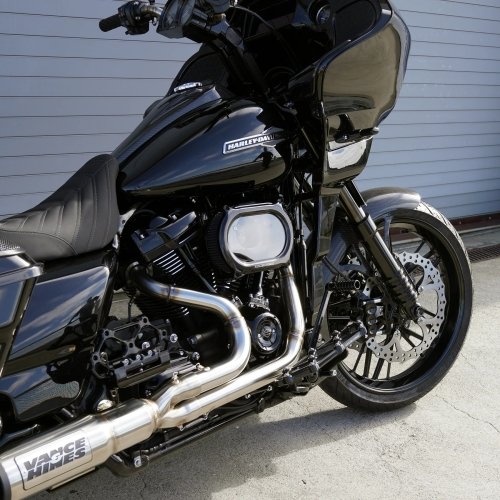

For our project, we chose the Arlen Ness Stage 2 Oval Air Cleaner. Its airflow capacity is probably excessive for a regular Stage 1 setup, but we liked its design and appearance.

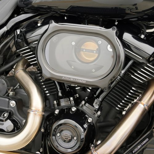

The Stage 2 Oval name itself suggests that the filter is suitable for upgraded camshafts and higher RPM. There is also a version with a transparent window in the front cover instead of the filtering element, but those filters do not have "Stage 2" in their name.
On Touring models, this filter looks especially harmonious and matches the massive M8 engine very well.

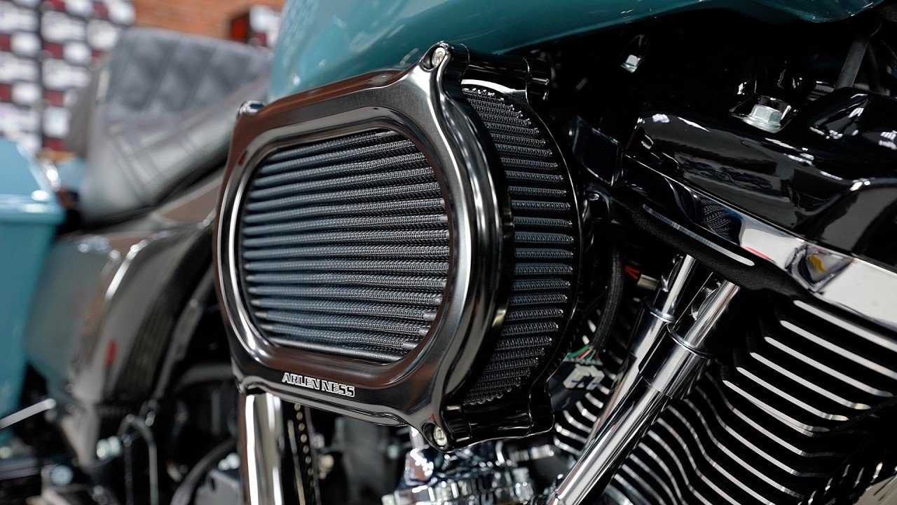

  • 01:39 Installing the Arlen Ness Stage 2 Oval.
  • 03:40 Arlen Ness Stage 2 Oval on the Street Glide 2024.
Overall, the installation is simple and does not require any fine adjustment or fitting, which is sometimes necessary with other intake systems.
