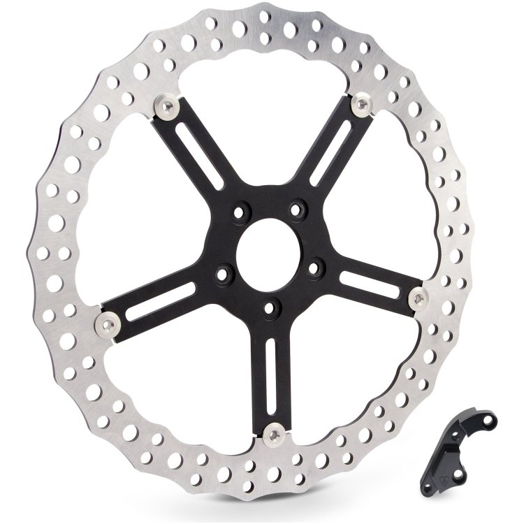

With the front brake system, we decided not to complicate things, especially since this does not make sense with the standard geometry and Sportster weight distribution. We decided to install an enlarged brake rotor, which will significantly increase the braking force with the same pressure on the lever.
An enlarged brake rotor must be floating so that its surface is always parallel to the pads. When heated, the metal deforms, and the movable mount allows the disc to take the desired position along the pads.
