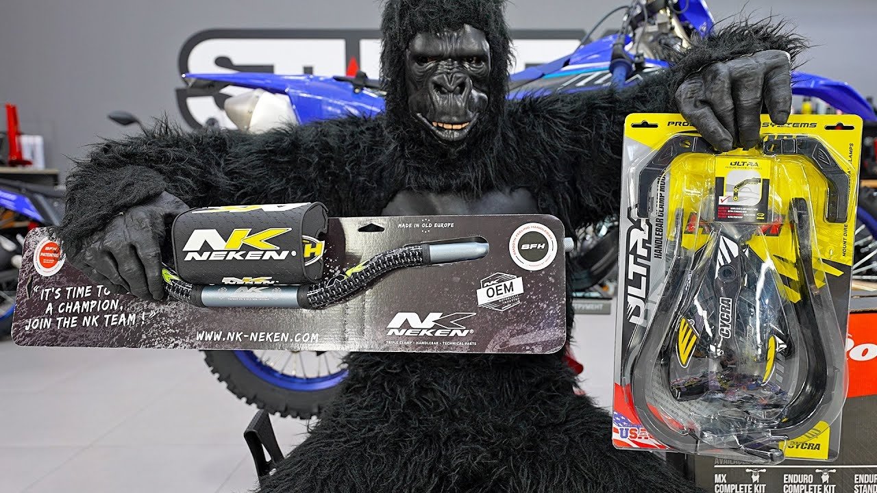

SFH Handlebars and Grips
SFH (Smooth Feeling Handlebar) Handlebars have a narrower diameter at the grip attachment points, which allows the use of thick-walled grips. The thick rubber layer not only damps bumps and vibrations better, but also provides better grip. Also, such handlebars allow you to install grips with a smaller outer diameter with the same rubber thickness.
Neken produces grips in three outer diameters: a standard 31 mm, a medium 28.5 mm and a small 26.5 mm.
The standard diameter provides the best damping. Grips are much thicker and softer than standard ones.
The medium diameter is the most popular, because the thinner the grip, the firmer the hold, which means less load on the hand muscles. At the same time, the grip is even softer and thicker than the standard one.
The small diameter is suitable for children and riders with smaller hands. The wall thickness of the grip is the same as the original.
Neken technologies not only reduce the load on the hands, but also reduce the risk of injury. For example, in rehabilitation, it helps to start training faster with less risk of relapse.
The installation of the SFH handlebar is nothing special or difficult, but it is not compatible with standard handguard mounts due to its too small internal diameter. In the video we showed how to install the Cycra Probend HCM handguard.
