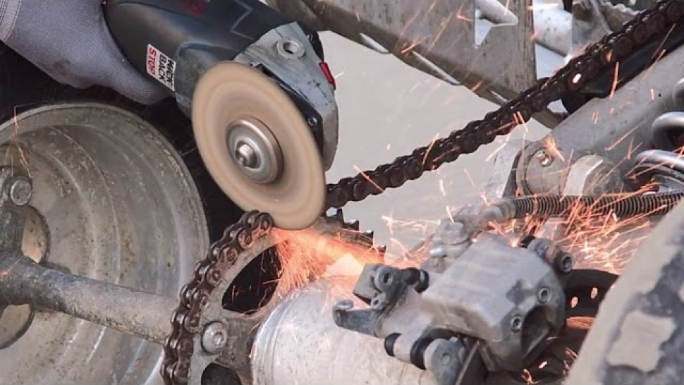

Replacing the chain and sprockets on a quad is fundamentally no different from doing it on a motorcycle. If you follow the correct procedure, this can be done quickly and easily. In the video, we showed the process using the example of a Yamaha Raptor 700 ATV. The article indicates the main points that you should pay attention to.

If standard sprockets are installed, then the chain length is determined by the manual. If non-standard, then the length needs to be determined on a case-by-case basis, with minimum tension. If the chain ends meet on different plates (outer and inner), you'll have to add another link to install the master link. It's better to increase or decrease the rear sprocket by an even number of teeth, and not change the front one at all. The stock chain on the Yamaha Raptor 700 has 98 links, and the front and rear sprockets have 14 and 38 teeth respectively. One tooth of a sprocket corresponds to half of a chain link, so it is better to increase (or decrease) a sprocket by an even number of teeth.
