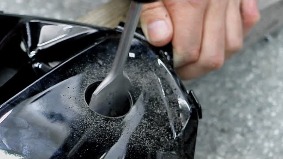

Plastic cutting
Plastic cutting is a very difficult procedure, especially if you haven't done it before. We trained on a piece of plastic from R6 with a drill and a cordless screwdriver with a spade bit. We came to the conclusion that it is better to cut with a screwdriver at low and stable speeds. When cutting, it is not necessary to press hard, just try to make small stable pressure, so the plastic doesn’t bend. Do not put anything under the cutting place, just cut unsupported. The plastic must be held very securely so it doesn’t vibrate or move. Choose a bit 3–4 mm larger in diameter than the bracket - the slider should not be close to the plastic.
Practice before doing it. There will be no second chance - you either make a good hole or screw up the plastic. The whole process and the results of the work can be viewed in the video. We did great!
