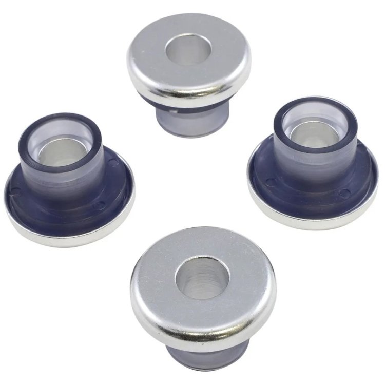

Standard rubber damper bushings in the upper triple clamp are too soft for high handlebars, and even the original handlebar pushed them hard. The bushings need to be replaced with polyurethane or fully metal ones - vibrations on new Softail models are small, despite the rigidly mounted engine.
