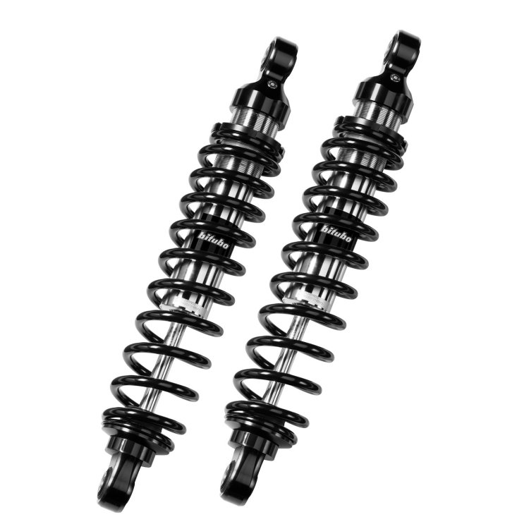

The best-value monotubes on the market are Bitubo WMB/WME (with rebound damping). They are well made, with larger damper, piston and spring diameters, aluminum mounts and stepless preload adjustment.
Unlike expensive models, the WMB/WME model damper resistance doesn't change during fast and slow compression/rebound and doesn't depend on the vibration frequency. During a slow civilian ride, this is not required.
Manufacturers often recommend installing shocks that are 0.5–1 inch longer. This almost doesn't affect the height of the motorcycle but provides more shock travel and therefore greater energy capacity.
There is also a catch here: not all models increase the shock travel when the length increases. The length can be increased by lengthening the rod or mounting supports. To increase the shock travel, you need to lengthen the damper. Legend honestly claims that its 12-inch and 13-inch shocks are equipped with different dampers, but the 14-inch model has the same damper as the 13-inch model: the length increase is achieved by lengthening the upper support. It means that when choosing a length, you have to compare photos online, because manufacturers rarely indicate the shock travel in the characteristics.
