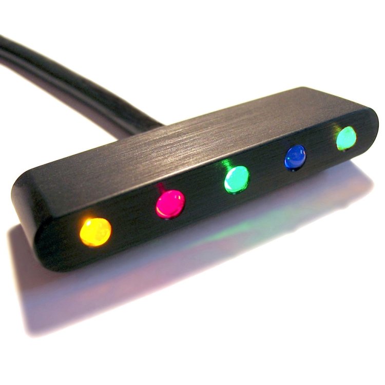

Clutch cable on BMW K1100LT has a non-standard tip. To install this cable on the ABM clutch, we had to make an adapter and bushing. As a result, it turned out elegant and functional, plus we managed to save the factory cable. We decided not to do the clutch sensor, because there is a neutral indicator, so the start of the starter on the transmission is not likely to happen.
