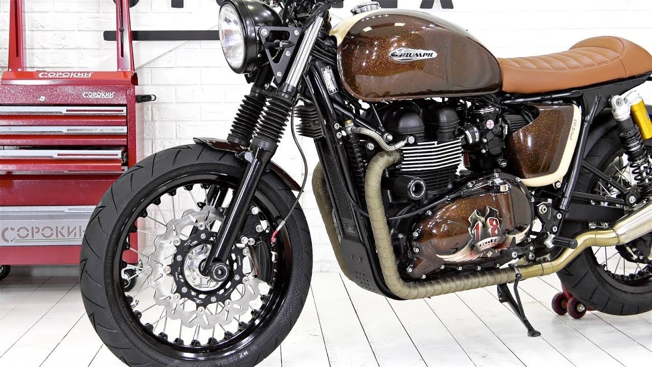

Triumph Bonneville is one of the most popular models for customizers, largely due to the base and geometry. The base of the motorcycle is not very long, so with a slight decrease in fork offset, wheels and suspension replacement, it is possible to achieve intensive and strong loading on the front wheel to make full use of powerful front brakes. Good projects based on Bonneville have powerful front brakes that are not only an accessory, but also a fully functioning system.
The standard brake system on the Triumph Bonneville is optimized well for the overall configuration of the bike. But the motorcycle itself is technically obsolete, and does not correspond to modern conditions of operation. Simply put: it accelerates much faster than the traffic around it but can’t stop as well; on a twisty road you have to slow down a lot, holding up traffic, because there is no feeling of stable grip when leaned over. In its standard version, the motorcycle is not urban, but suburban.
The cheapest way to upgrade the front brakes is a floating disc of a bigger diameter and a caliper with a larger piston area (the 4-piston Brembo 30/34 and 6-piston SPIEGLER/ABM work well). But without a fork upgrade this setup will not be significantly more efficient.
In this video, we showed a simple way to install a non-standard caliper: using an aluminum adapter. The standard brake hose is a bit short, but in our case an aftermarket braided hose was already fitted. As a result, we can say that such a system is good in terms of price / quality ratio. The dual disc brake, which we did on our SXRacer project, works better, but requires a whole range of complex, expensive modifications.
