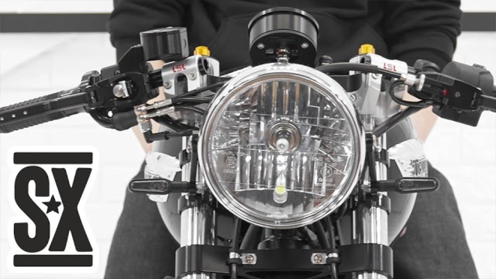

Headlight, front turn signals
On the stock bike, the ignition lock sits inconveniently on the left headlight mount, so we moved it to the frame. Instead of the standard headlamp, we chose the LSL Clubman headlight. At first glance, it is the same as the standard one, but the LSL Clubman is much lighter (aluminum body and plastic lens) and slightly smaller in size, which is why it looks better on the cafe racer. For its attachment, we used LSL lightweight aluminum holders with holes for turn signals. Installing these holders creates one problem: they meet the headlight mount at an angle, so you need to put washers or machine a special bushing (looks better), which we did.
We chose D-light turn signals with a bright diode in an aluminum case and a rubber damper, which dampens vibrations. Connectors from the turn signals can be hidden in the headlamp. Connectors have to be assembled from scratch. On the Triumph Bonneville, the turn signal rubber dampers are just extra insurance: the bike is well made and there is no vibration at the handlebar.
