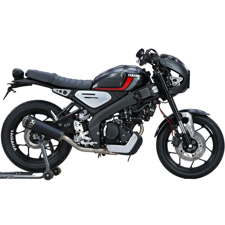

With the original relay, LED turn signals blink at a higher frequency because they have lower resistance. While this doesn’t compromise safety, for those who want to do it right, the best solution is to install a digital relay. Additionally, on some motorcycles, turn signals stay on constantly when activated, making relay replacement necessary.
In our opinion, the best solution is the Motogadget Mo.stop digital relay. It offers various operating modes, works with both turn signals and brake lights, and is compact, water-resistant, and vibration-proof.
We recommend this relay because it has various operating modes, including an automatic shut-off mode after 20 seconds. This automatic shut-off mode is perfect for motorcycles with push-button turn signal controls. On motorcycles with a joystick on the left control panel, you’ll need to deactivate the turn signal by pressing the joystick before switching it back on in the same direction.
The smooth fade-out and fade-in modes also work great with light bulbs. With extremely bright turn signals, this mode doesn't work as well, because even in the fading phase, such turn signals shine brightly and seem not to turn off. This is clearly visible in the video! That is why it is important that the relay has a standard operating mode with instant on/off.
For brake lights, the relay has highly noticeable light signaling modes, although they aren’t certified for public roads. Installing the Motogadget relay into the brake light power wire is a quick and effective solution.
This relay also blocks quiescent currents that drain the battery even when consumers are not turned on. This is especially important with powerful LED optics.
