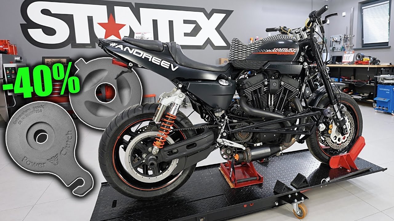

Alexander Andreev's stunt bike XR1200 has an easy-pull clutch actuator with a shortened lever arm. However, you still need to apply about 10 kg of force to pull the clutch on this bike. This is a lot even for civilian use, and for stunt riding it is not acceptable, since the lever must be pulled with one finger while the other fingers hold on tight.
To make the pulling easier, we installed the Muller Power Clutch, which is available on all models of Harley-Davidson with a cable-operated clutch. The mechanism has a longer lever, which reduces the pull effort by 40%.
Before installing the Muller Power Clutch with the easy-pull actuator, we were worried that with the fully pulled lever, the clutch would not disengage. Both the machine and the Muller Power Clutch reduce the travel, which together could limit how far the plates separate. But this did not happen: the clutch fully disengaged. While performing stunts, it's better if the clutch disengages a bit earlier, because then you won't need to fully pull the lever. That's why we installed a spacer that moves the lever away from the handlebar — it worked out great!
