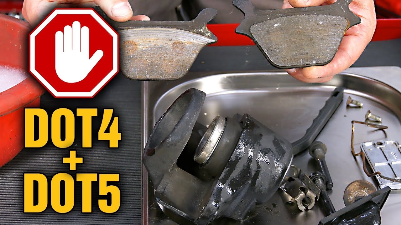

We didn't find any information online if DOT4 in DOT5 system can create any problems, but we faced it ourselves. Alexander Andreev filled up his FXR rear brake system with glycol-based DOT5.1. As a result, the caliper piston wedged up and didn't return, the pads were worn down to the base and ruined the brake disc.
We haven't found the reason why it happened. There was something black on the cylinder walls, but the rubber seal wasn't damaged. The paint on the fittings flaked off and got into the liquid, so the liquid had clots in it. All this slag didn't allow the piston to move freely, which is why it wedged.
In the video, we showed the caliper repairing process, how to replace the brake hose and brake disc. The system was pumped with a vacuum pump - the fastest and most efficient way. We didn't disassemble the main cylinder. Instead, we just washed it with fresh liquid. But we know that if DOT5 is poured into the DOT4 system, all the cylinders must be disassembled and washed, as the silicone DOT5 is washed out very badly and can remain in the cylinders.
