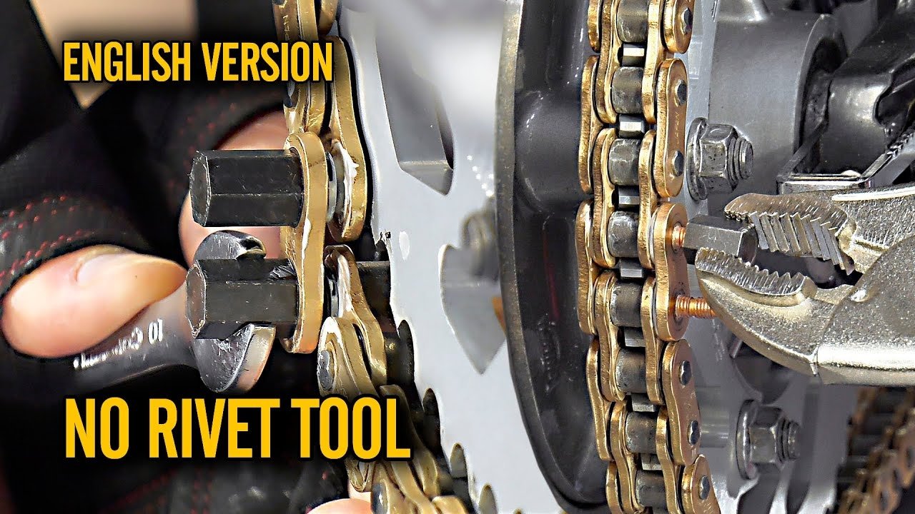

We decided to test the EK screw type master link, which is installed without a special tool. How to press master link is shown in the video, but we did not say that the outer plate of the link is slightly thicker than the others - this is done for a more secure plate fixing on the pins.
In the video, we say that master link is non-universal. This is due to the fact that different chain models have different plate thicknesses, so nuts can pull the link too tight or not pull it enough. If there is no way to check the thickness of the plates, then we do not recommend buying master link at random - it may not fit.
Despite the simplicity of the process, the link can be damaged, so we recommend to use a caliper gage, especially before breaking off the pins. The internal distance between the outer plates should be the same as on the other links.
