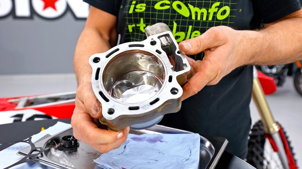

According to the service manual (factory instructions), the piston should be replaced every 15 engine hours. A popular opinion among motocross riders is that on bikes like this, piston replacement is typically done at 90–100 engine hours. Gena follows a less common view: if you change the oil on time and constantly monitor the condition of the air filter, replacing the piston once every 150–200 engine hours is sufficient. In this video, we tested which opinion is correct.
The replacement shown was performed at 160 engine hours. The piston showed only initial wear, and Gena confirmed that the replacement was done at the right time — it could have even been ridden longer. The cylinder and other engine components were in excellent condition. A standard-size piston can be installed.

  • Before installing a new piston, it is advisable to test-fit it in the cylinder. Insert the piston (without rings) into the cylinder in the correct orientation. The piston should move freely inside the cylinder without binding. There should be no longitudinal play; slight lateral play is acceptable. Check this at different insertion depths.
