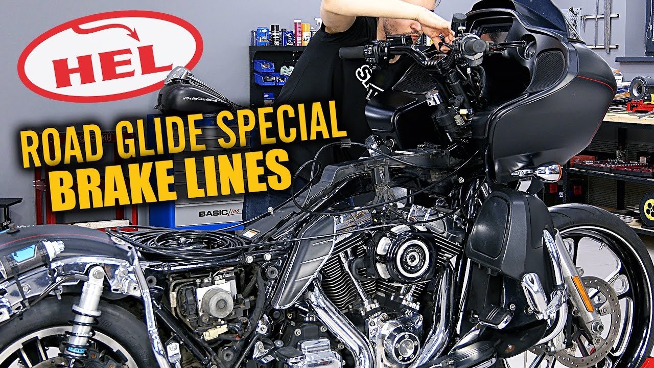

We have installed a 23-inch front wheel and 2-inch longer fork tubes with Legend fork cartridges on a Harley-Davidson Road Glide Special 2015 to make wheelies easier. This setup requires longer brake lines from the calipers to the ABS module. Here is the assembly and installation of brake lines made of HEL components. The procedure is rather complex because you need to install brake lines twice: to determine the length and after crimping.
HEL components are very good for custom brake lines, as you can bend the fittings to any angle. Also, they can be rotated after crimping to relieve torsion stress. These are great advantages!
